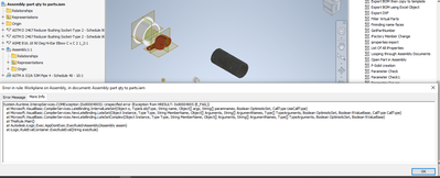

kaomar23
more info in the message error
Message 9 of 11
A.Acheson
Ok try it on a part that is not read only . Select part and press esc this cancels the loop and allows to work on the part selected. It is possible read only parts were selected . I selected a read only part below and it errored out
To get around the read only file error you can place an On error resume next which will move on to the next file if an error occurs. It would be better to check the status of the file if read only or not but this can be difficult to achieve.
