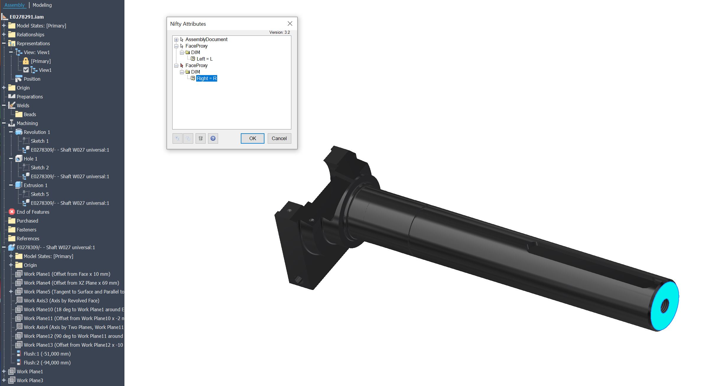

I am working on automating some drawings. For a weld assembly, I use machining to adjust certain features because my step always varies. Using nifty attributes, I created two attributes: one for left (left = l) and one for right (right = r). I can find these when I search for the attributes in the weld assembly.
However, when I try to find these attributes in the .dwg, I can't locate them, so I'm unable to add dimensions. Does anyone have a solution for creating a drawing with a weld assembly, or should I take a different approach? If it’s a part, I can use the “assign entity name” option.
This is the code I want to use bur everytime i got the message "Not all faces found!" , I found it through the following link:
https://www.youtube.com/watch?v=bcOvYc6rNUk

I tried using the AllReferencedDocuments, but it doesn't work. It works in a normal assembly, but when I use a weldment, I can't find the attributes anymore.
When I place the same part in a weld assembly, I get the following error message. I have the impression that you need to approach a weldment differently
I get the following error message at this line, which I don’t get in a normal assembly
  oCompOcc.CreateGeometryProxy(Face1, oOccFace1Proxy)
