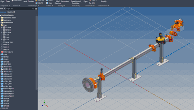

Hello, so i have been using a snippet of code to replace designer name, project & date based off of form entry on multiple configurators for a while.  But today i cant get it to work on this particular sub assembly.  The issue has to do with which ever part is first in the tree.  If the first item is suppressed, no matter which part, it will run no issue, if the first part isnt suppressed it errors out...  Any help would be appreciated, thank you
It errors out on line iProperties.Value(oOccurrence.Name, "Project", "Project") = _
'Goes through all parts & subassemblies and replaces the Project based on form inputs
Sub iPropPartsProject
Dim oAsmCompDef As AssemblyComponentDefinition
oAsmCompDef = ThisApplication.ActiveDocument.ComponentDefinition
'Iterate through all Of the occurrences
Dim oOccurrence As ComponentOccurrence
For Each oOccurrence In oAsmCompDef.Occurrences.AllReferencedOccurrences(oAsmCompDef)
		'create iprop with default Value
		iProperties.Value("Project", "Project") = Project
		'write to component iprops
	On Error Resume Next
Next
End Sub

A.Acheson
Try it with a Try Catch Statement. You can also put a logger in the catch to see which iproperties are not changed.
	'create iprop with default Value in Main Assembly
		Try
			iProperties.Value(oOccurrence.Name, "Project", "Project") = iProperties.Value("Project", "Project")
		Catch
			Logger.Info("Failed to Set iproperty in : " & oOccurrence.Name)
		End Try
	Next
End Sub
and you can avoid content center parts with this
	If oOccurrence.Definition.Document.IsModifiable Then
			'Do Something as document is writable
		End If
Regards
Alan
