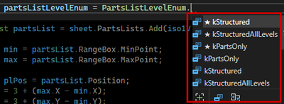

		oPlacementPoint = ThisApplication.TransientGeometry.CreatePoint2d(postionX, postionY)
		Dim partsListBomType As PartsListLevelEnum = 46593
		'''Name					Value	Description
		'kFirstLevelComponents	46593	First level components.
		'kPartsOnly				46594	Parts only.
		'kStructured			46593	Structured first level components.
		'kStructuredAllLevels	46595	Structured all components.
		Dim oPartsList As PartsList = oSheet.PartsLists.Add(oDrawingView, oPlacementPoint,partsListBomType)

Thanks for the hint.
Strangely, it worked with all other test assemblies without the optional parameter.
kFirstLevelComponents appears to be deprecated. It's not exposed through the API.
