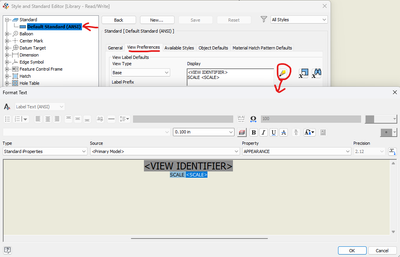

I believe you can do what you want without iLogic.  The StylesManager has a View Preferences section where you can edit the default view label:
Let me know if this does not achieve your goal
