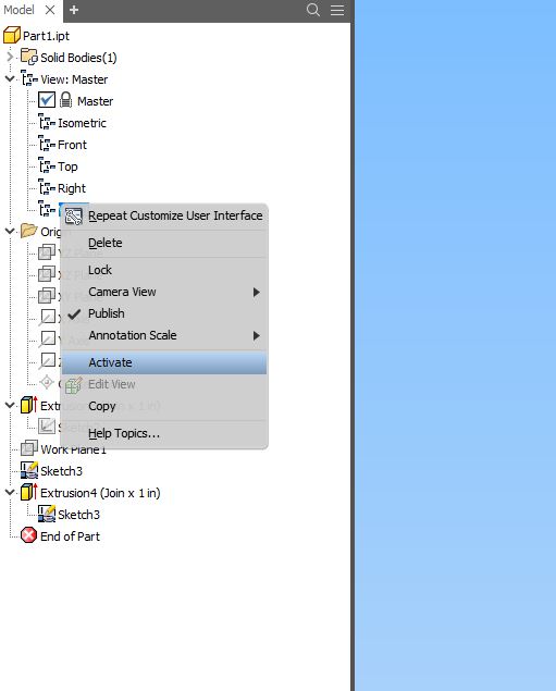

i'm trying to change the current view using vba.
with the user inreface i can just right click the view name (master,front,View1 ect.) and select activate.
thank you
1,166 Views
Sergio.D.Suárez
Hi, with this VBA code you could change the design view representation, through the item number (the number highlighted in red)
