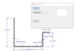

Hello again,
Is there a way to get all the angular  parameters into a Checked listbox to select them?
I have no Idea how to sort them and to populate the listbox.
Any help would be apreciated
something like this

j.romo
Thanks for the aproach, I will try to make the Loop  (but I am not as skilled yet) and I have to investigate how to fill the Check boxes.
I would like to select in the box the parameters to change, i am making a simple unfolding Flower for rollforming
In the chkBox I would like to have the angle dimensions so I can select some of them and apply angle changes in diferent sequences.
right now I cant even populate a simple textbox when a domension is selected 😞

j.romo
The idea is to select 1 or more angles and change them at the same time.
The code worked like a charm, even I could modify it to update as you add more angles or change the angle name parameter.
the goal is to meke somethin like the pic below
create a new WP and Sketch and project the resulting geometry with its changes
to get a unfolding sequence of the main profile.
