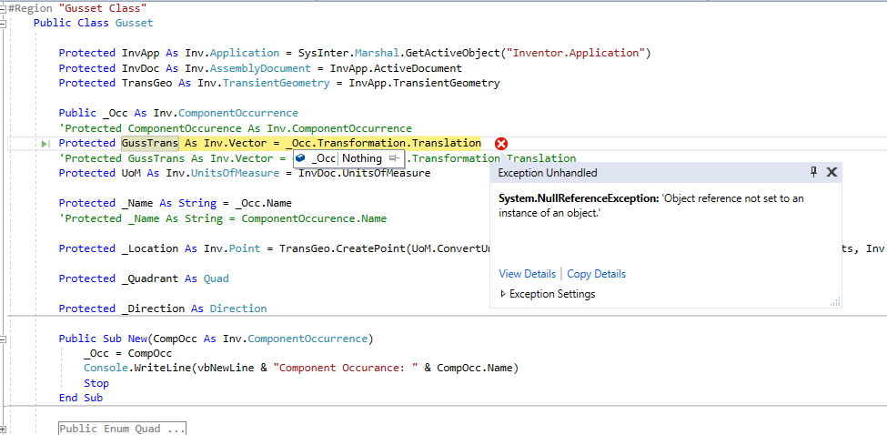

I am setting up a class that will:
  • hold the component occurrence
  • get the name of the comp occ
  • define a position quadrant from the matrix of the comp occ
  • define the direction the part is facing from the matrix of the comp occ
I can pass a component occurrence to the class via "Public Sub New" however I cannot pass that occurrence to a variable which can be read to make the above list. Is a component occurrence an unacceptable data type to be handled by a class?

I don't see where you are trying to Add the Occurrence variable to a list, but you should be able to to what you want with the Gusset._Occ.
I believe the issue is you have defined it as Protected, try defining it as Public. Protected means it can only be used in your Gusset class or any derived from it.
snappyjazz
@Anonymous
Thanks for responding. I switched the _Occ variable to Public and it still comes up empty.
Oh I see. I think the issue is that it's trying to set your class variables before it runs your Sub New. So you're going to want to put anything that uses _Occ in Sub New or where ever you actually us the variable. For example,
Public Sub New(CompOcc As Inv.ComponentOccurrence)
            _Occ = CompOcc
            GussTrans = _Occ.Transformation.Translation
        End Sub
Private Sub AssignDirection()
            Select Case True
                Case GussTrans.Cell(1, 4) > 0 AndAlso GussTrans.Cell(3, 4) > 0
                    _Direction = Direction.BACK
                Case GussTrans.Cell(1, 4) > 0 AndAlso GussTrans.Cell(3, 4) < 0
                    _Direction = Direction.FRONT
                Case GussTrans.Cell(1, 4) < 0 AndAlso GussTrans.Cell(3, 4) > 0
                Case GussTrans.Cell(1, 4) < 0 AndAlso GussTrans.Cell(3, 4) < 0
            End Select
        End Sub
snappyjazz
That's what I was missing. Thank you!
