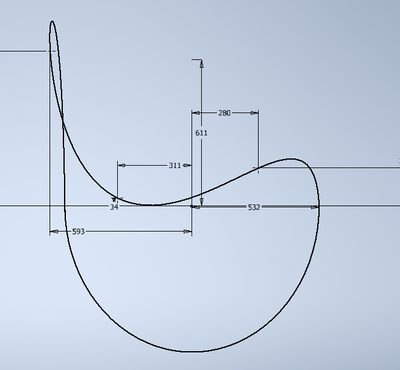

Hello!
I've been trying to make a rule that creates a random closed polygon, but have been running into some complications. The end goal is to make 2 random polygons the have a loft between them.
In my previous approach, I made a generic shape by placing a bunch of points then making a spline between them. Then through I rule I randomized all the dimensions to create a new shape, which usually would not be a polygon (lines would cross, example image below).
Anyways my idea around this was to simply put the randomizing code in a while loop that keeps repeating until the loft is active. This is not working though because I am assuming it runs once and cant check if the loft works until after the rule is done, but what do I know.
Here is my code:
If anyone has any ideas on how to get this to work all help would be greatly appreciated. Thanks!

J-Camper
Are you trying to make regular or irregular polygons?
If you are after regular Polygons, there is a SketchLines Method specifically for that: AddAsPolygon
If you are after irregular Polygons, there will be a lot of custom coding needed.  Let me know if this is the goal, but I'm not going to even start to go down that rabbit hole if you are only after regular polygons.

J-Camper
Okay, can you answer a few questions for me:
What is the reason you chose spline over lines?  Do you need tangency?
Can you create and post an example of your end goal through GUI? [i.e. set one up manually as a target example]
Do you have inner and outer bounds for the randomization? You are current randomizing every dimension between 0 and 750 cm, will the bounds always be the same?

morrig14
I am trying to create random wind turbine blades. The end goal is to create a bunch of random lofts between the 2 sketches and have them be relatively aerodynamic (but they don't have to be). What I am going to do once I get these randomized "blades", plan on running simulations on them using Inventor Nastran and some machine learning to optimize the blade for efficiency.
I decided to use spline because I thought it would make it more likely to make the blade aerodynamic and then would require less test cases.
I attached below the ipt of the original blade design that I am trying to optimize, so it is essentially the target example. I was not really sure what you meant by the posting my end example through a GUI (like a form where you choose all the dimension sizes?)
Finally they all are just randomly 0 to 750, which seeing now is a very bad idea, but I have absolutely no clue how I could determine better bounds for each dimension while still making it random. Maybe take the example dimensions and add or subtract some random number from that?
Sorry that's a lot but thanks so much for being so helpful!
