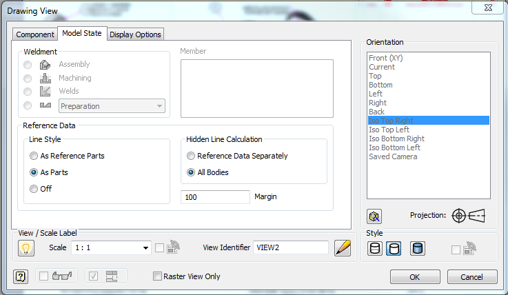

I am truing to write a quick iLogic rule to cycle through all sheets of a drawing and change the reference data options to the following:
Line Style: As Parts
Hidden Line Calculation: All Bodies
Margin: 100
(see attached image)
I have the basic for each loops to go through each sheet and each drawing view but I'm not sure on the code required to change these values. There doesn't appear to be a reference anywhere of the commands available.
Many thanks

I also did not found anything under the drawingview object, so probably the api is not exposed.
Only Autodesk can confirm this i.
@Anonymous is there a list available of things that are not exposed, this would help us save lot of time 🙂

I found this post earlier which details the iLogic required for turning off "Definition in Base View". However I can't find the command that was called up in this iLogic anywhere so I'm hoping there are other hidden commands for what I require.

My comment related to the original question. We can't access the DrawingView.ReferenceDataDisplayStyle property via the API. It is not even documented.
It works with VBA:
Sub HideReferenceLines(ByVal drawingView As drawingView)
    drawingView.ReferenceDataDisplayStyle = kDisplayStyleOff
End Sub

have code that will adjust the margin

here is the code for the Hidden Line Calculation: All Bodies
DrawingView.HiddenLineCalculationForAllBodies() As Boolean
