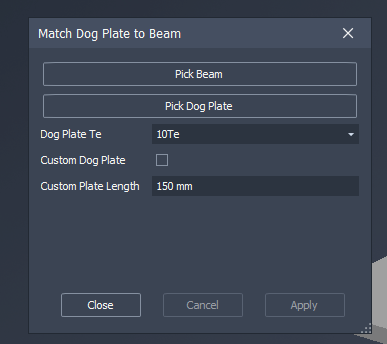

Is it possible to use iLogic to create a code where I have a ‘Override’ checkbox (true/false parameter), that enables and disables other features within the form? In this instance, I have a mutivalue form feature 'Dog Plate Te' that I want to be selectable when 'Custom Dog Plate' is unticked and the 'Custom Plate Length' not selectable. Vice versa for the opposite of course. Is this a possibility?
See below image.

Create a boolean parameter and then go to the form and select the parameter row you want to control and then go to Enabling Parameter section and select the parameter used to control the previously selected row. See form help page here.
Enabling Parameter Name
Defines the name of an Inventor true/false parameter. Setting this parameter to True enables this control.

You are an absolute legend @A.Acheson !!
Thank you so much!
