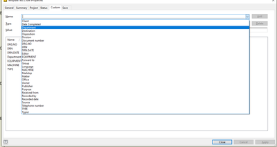

Hi, I am currently trying to create a new title block system for my company, however I am running into a strange issue. I cannot create a custom iProperty titled "DEPARTMENT", in all caps, as there is a default iProperty titled "Department". The caps is crucial as our previous title block attribute is in all caps, and for data extraction in AutoCAD, which is caps sensitive for attributes.
Does anyone know a way around this? How to modify/delete this default list?

Ben.Tassell
Using the VBA code in the article you sent, you don't end up with 'Department' as one of the properties... It must be a different list in that dropdown menu than what the existing properties are.

Ben.Tassell
Same issue with the no template inventor drawing. Not sure the template file has anything to do with it that I can see.
