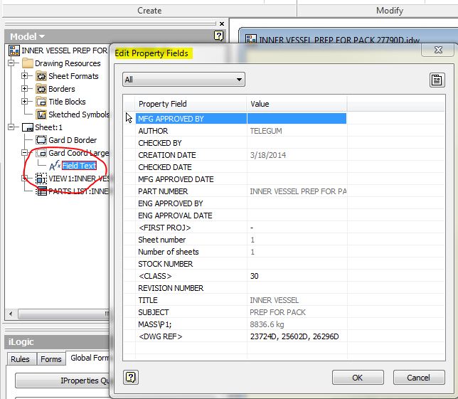

I'm using Inventor 2014.
I would really like a possibility to use Field Text within forms, I am open however to Ilogic.
Is it possible to send Field text to custom properties?
Ex:
<FIRST PROJ>
CLASS
<REF DWG>
I am aware that these values are not universal or [DEFAULT] but is it possible to push them or populate a new custom property which i can modify that would then if changed in a form it would populate field text?
Step 1
Ilogic, pushes to custom property.
fill in form.
run step 2
pushes custom values back to field text.
(instead of using forms, i am open to using txt boxes too)
In Reality i would rather just assign field text in form and be done with it, but it's not that easy as far as i know. Thank you for your consideration in this matter. I'm not asking for you to code the whole thing for me, just any code snippets would be enough for me to work off thanks!

I'm not sure what exactly you need. Are you talking about Prompted Entry values or Property values?
The best thing would be if you could provide a very basic, non-confidential drawing and then let us know what exact value inside it you'd like to get back programmatically.

Not sure what your last comment means 🙂 but there are some blog posts on setting a prompted entry to a given value, e.g.: http://adndevblog.typepad.com/manufacturing/2013/09/put-a-drawing-view-name-to-prompted-entry-symbol...

Is there a reason you have to use field text? Why not just create custom iProperties within the drawing file? This way you can add the iProperties directly to your form.

It's not that there is no way to do it with field text, I've done it. It's just that it is WAY more effort than it is worth, especially when there is an easier and, more importantly, better way.
The only disadvantage to using drawing properties is it wont work with multi-sheet drawings, but if your company doesn't produce these then there is no problem and it stands as the best method on all measures.
