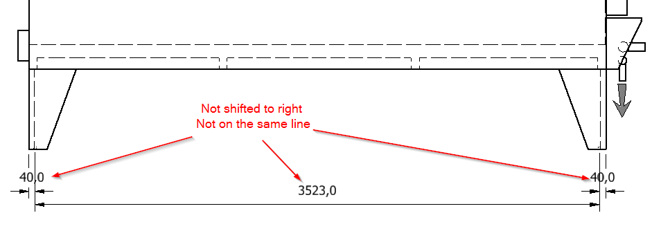

I have an iLogic rule. The part that I have problems with looks like this:
Dim Sheet_1 = ThisDrawing.Sheets.ItemByName("Sheet:1")
Dim VIEW1 = Sheet_1.DrawingViews.ItemByName("VIEW1")
Dim dimensions = Sheet_1.DrawingDimensions.GeneralDimensions
' Get all intents
Dim legIntent1 = VIEW1.GetIntent("LegMount1", PointIntentEnum.kMidPointIntent)
Dim legIntent3 = VIEW1.GetIntent( "LegMount3", PointIntentEnum.kMidPointIntent)
Dim sideIntent1 = VIEW1.GetIntent("side1", Nothing)
Dim sideIntent2 = VIEW1.GetIntent("side2", Nothing)
' Placement logic
ThisDrawing.BeginManage()
Dim textPointJustUnderView = VIEW1.SheetPoint(2, -0.2)
dimensions.AddLinear("Mounting point1", textPointJustUnderView, sideIntent1, legIntent1)
dimensions.AddLinear("Mounting point2", textPointJustUnderView, sideIntent2, legIntent3)
dimensions.AddLinear("LegMountDim1", textPointJustUnderView, legIntent1, legIntent3)
ThisDrawing.EndManage()
When I run this rule I get the following result
I expected a result like this:
for all dimensions I use the same text point offset but they are not inline. for some reason it also does not matter what I set in the x direction for the text point it is always centered.
This is all done with iLogic API/code but when I do the same with the inventor API then I can get the expected results. (I wish I could just give a Point2D to the AddLinear function. Those sheet points dot work for me....)
Can any one point me in a direction that will get me the expected results without using the Inventor API.

Curtis_Waguespack
Hi @JelteDeJong
I have never seen the X value do anything at all, for a horizontal dimension.
If you are placing a horizontal dimension it seems to only look at the Y value, and just ignores the X value.
If you are placing a vertical dimension it seems to only look at the X value, and just ignores the Y value.
That seems to just be how it works... unless I've missed something.
In fact I generally instruct people to enter zero for the X when placing a horz. dim and zero for the Y when placing a vert. dim just for clarity.
Maybe Mike Deck can confirm this is just how it works, or help us understand how to get the expected results? @MjDeck
I hope this helps.

Also, I think the 40 dims not being on the same line, might have something to do with the dim style overriding the placement, because there is not room???
I'm not sure... but based on your code, I would have expected them to land on the same line.
You might try the same thing with a larger space ( 100 instead of 40) or a larger view scale, to see if the dim style is forcing it off the line for some reason.

MjDeck
@JelteDeJong , here's a way that works for me, using the SheetPoint function. But I didn't see the problem with vertical placement. That might be dependent on the dimension style.
If you can make it work with API code using Point2d coordinates, it should be possible to do the same with iLogic. You can use Point2d instead of SheetPoint. It just requires some conversion. I'll post a separate reply for that.
Here's SheetPoint code. Note how it turns off the CenterPoint option. This will prevent iLogic from automatically moving the outer text inside the dimension lines.
Dim saveCenter = ThisServer.DrawingOptions.CenterDimensionText
ThisServer.DrawingOptions.CenterDimensionText = False
Try
	' Placement logic
	Dim textPointJustUnderView_center = VIEW1.SheetPoint(0.5, -0.2)
	Dim textPointJustUnderView_left = VIEW1.SheetPoint(-0.05, -0.2)
	Dim textPointJustUnderView_right = VIEW1.SheetPoint(1.05, -0.2)
	dimensions.AddLinear("Mounting point1", textPointJustUnderView_left, sideIntent1, legIntent1)
	dimensions.AddLinear("Mounting point2", textPointJustUnderView_right, sideIntent2, legIntent3)
	dimensions.AddLinear("LegMountDim1", textPointJustUnderView_center, legIntent1, legIntent3)
Finally
	ThisServer.DrawingOptions.CenterDimensionText = saveCenter
End Try

Here's an example using explicit Point2d coordinates. The textOrigin argument to the iLogic AddLinear function is  a DocumentUnitsPoint2d object. This is in document units. Otherwise it's very similar to the API Point2d object. You can set its coordinates from a Point2d.
Try
	' Placement logic
	Dim y_offset = -8 ' in drawing units
	Dim textPointJustUnderView_left = ThisDrawing.Geometry.Point2d(0, 0) ' create new point in document units
	textPointJustUnderView_left.InDatabaseUnits = legIntent1.PointOnSheet ' this sets the point in document units
	textPointJustUnderView_left.X = textPointJustUnderView_left.X - 40
	textPointJustUnderView_left.Y = textPointJustUnderView_left.Y + y_offset
	Dim textPointJustUnderView_right = ThisDrawing.Geometry.Point2d(0, 0)
	textPointJustUnderView_right.InDatabaseUnits = legIntent3.PointOnSheet
	textPointJustUnderView_right.X = textPointJustUnderView_right.X + 40
	textPointJustUnderView_right.Y = textPointJustUnderView_left.Y
	textPointJustUnderView_center.Y = textPointJustUnderView_left.Y
Finally
End Try

JelteDeJong
@MjDeck Thank you for the examples!
Setting the option "ThisServer.DrawingOptions.CenterDimensionText" solved the issue that the x value was ignored in the sheet point.
However, that did not solve the issue that the dimensions were on the same line. I did discover a couple of other things that led me to the solution. The dimensions are inline the first time I run the code. Only on the sequential runs will the dimensions get out of line. (That makes me expect there is a bug in the text position API.) This bug shows itself only when you have some style settings. These are those settings:
I managed to work around the issues by setting the options to the desired values and then back again. (like you did with the centre option.) The complete workaround for all issues creates a lot of code but it seems to work. (I could/should test it a bit more.) Here is the important part of the code that seems to work.
Dim style = ThisDoc.Document.StylesManager.ActiveStandardStyle.ActiveObjectDefaults.LinearDimensionStyle
Dim style1 = style.HorizontalDimensionTextOrientation
Dim style2 = style.AlignedDimensionTextOrientation
Dim style3 = style.VerticalDimensionTextOrientation
style.HorizontalDimensionTextOrientation = DimensionTextOrientationEnum.kInlineHorizontalDimensionText
style.AlignedDimensionTextOrientation = DimensionTextOrientationEnum.kInlineAlignedDimensionText
style.VerticalDimensionTextOrientation = DimensionTextOrientationEnum.kInlineHorizontalDimensionText
' Add dimensions here!
style.HorizontalDimensionTextOrientation = style1
style.AlignedDimensionTextOrientation = style2
style.VerticalDimensionTextOrientation = style3

JelteDeJong
Just for documentation. I transformed the code from the OP to this rule:
Public Sub Main()
	' Get all intents
	Dim legIntent2 = VIEW1.GetIntent("LegMount2", PointIntentEnum.kMidPointIntent)
	Dim legIntent3 = VIEW1.GetIntent("LegMount3", PointIntentEnum.kMidPointIntent)
	' Setup default values
	Dim y1 = -0.3
	Dim horizontalDimType = DimensionTypeEnum.kHorizontalDimensionType
	Using manager As New ILogicGroupManager(ThisDrawing)
		' Placement logic
		manager.CenterDimensionText = False
		dimensions.AddLinear("Mounting point1", VIEW1.SheetPoint(-0.07, y1), sideIntent1, legIntent1)
		dimensions.AddLinear("Mounting point2", VIEW1.SheetPoint(1.07, y1), legIntent3, sideIntent2)
		manager.CenterDimensionText = True
		dimensions.AddLinear("LegMountDim1", VIEW1.SheetPoint(0.5, y1), legIntent1, legIntent2, horizontalDimType)
		dimensions.AddLinear("LegMountDim2", VIEW1.SheetPoint(0.5, y1), legIntent2, legIntent3, horizontalDimType)
	End Using
End Sub

For demonstration purposes, I added an extra dimension. As you can see the SheetPoints.X values of the LegMountDim1 and LegMountDim2 are the same but the texts are nicely centred.
