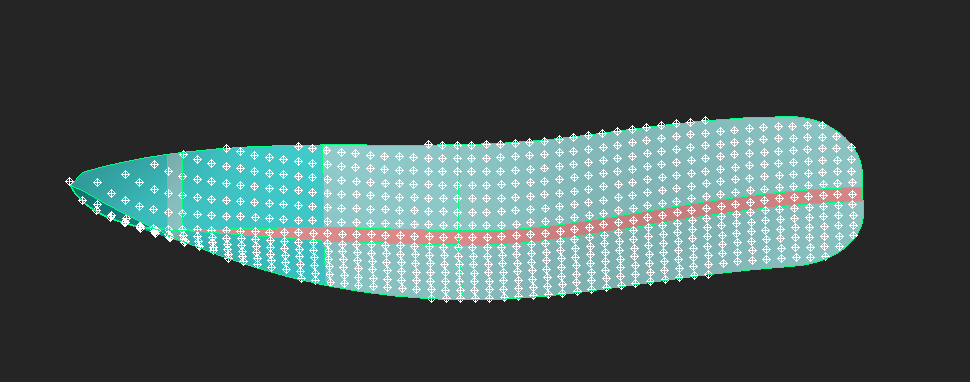

So after some testing, I don't think getting the faces from NamedEntities works the way we're trying to use it,but all is not lost. I borrowed Jhoelforshav's method of creating a surface body from the faces and used that instead. This is the result.
There are a couple issues. There are several stragglers that aren't an intersection that I have no explanation for. Also it seems Jhoelforshav's method left out those 2 middle faces without workpoints. It also seemed to include the XY plane because the first couple tests there was a flat plane of workpoints underneath the hull. I was able exclude it manually as you will see in the code. I'm not sure how much further I can go with this because I don't really know how Jhoelforshav's method works, why it left out those 2 faces and included the XY plane, or why it created some points that aren't an intersection. I will post the code, but beware it took almost 10 minutes to run. This code is going through every axes and checking if intersects each face. I included a check so if it created a point for an axis it will stop trying to create points for that axis. It also skips the XY plane in the if statement (Not k = 3).
Honestly, I would recommend using Jhoelforshav's solution as it seems way more elegant and flexible

After stitching together some more of Jhoelforshav's code, I nearly have it. the only thing missing is the naming.

Message 34 of 35
Naming them was a lot easier than expected. This code should do exactly what you are looking for and it's fast.

Message 35 of 35
jessey9X6M8
Awesome!
As advertised, it does all I need it to, and it works fast.  Thank you for your herculean efforts.
Also, thank you to @JhoelForshav for having the key insights that I was not ready for several days ago.
