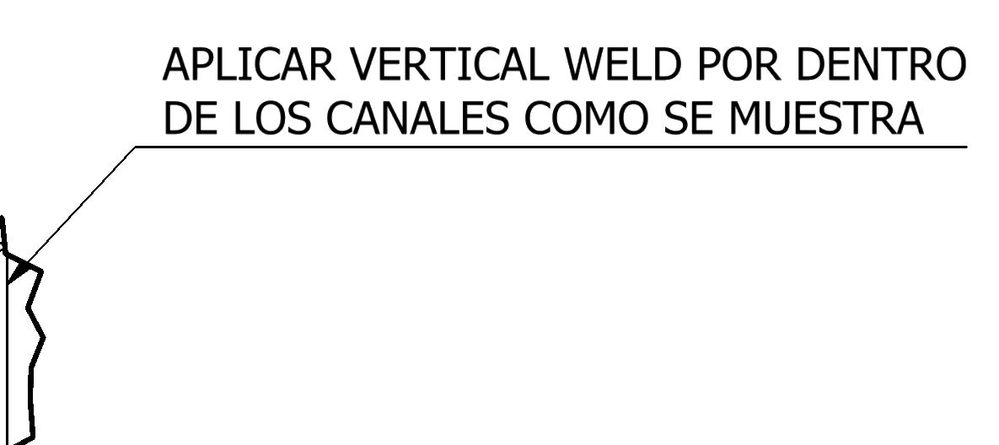

I am converting the drawing which has so many notes in other languages such as Spanish etc.
Can we make an i-logic to replace all notes with defined text from any language using i-logic?
RGds
688 Views
Michael.Navara
For static text is it very easy, but you need to specify languages from and to.
But this approach is very vulnerable. When somebody change anything in the text, this method can't translate it.
Better approach is to use some "textId" stored in LeaderNote attributes. Then user can specify this textId (select from list of corresponding texts) and then you store this id to attributes. When you start translation, you just read this textId and from target dictionary select appropriate text.

didin.suryadi6JREK
Hi Michael
Thanks, can you please give some example to put on the i-logic below
- from Spanish to the Indonesian language
- old text: COMO SE MESTRA
- new text: SEPERTI PETUNJUK
Appreciated your help and advise
