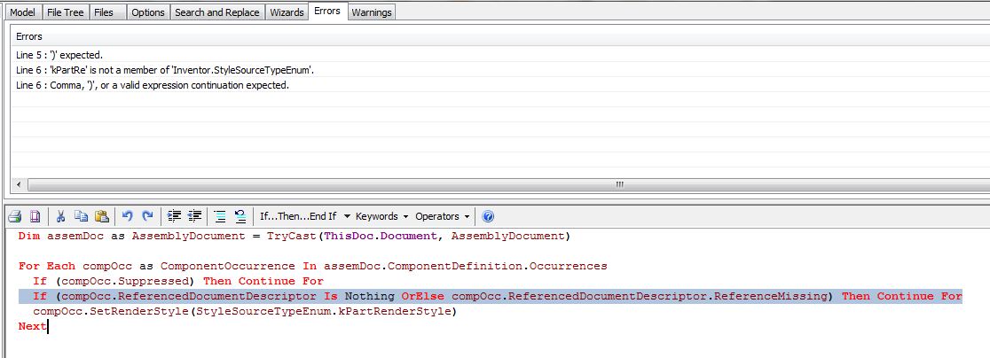

Hi Mike, thanks for the quick response. I set up a test, and am getting an error running the rule:
Rule Compile Errors in Rule1, in Assembly2.iam
Error on Line 5 : ')' expected.
Error on Line 6 : 'kPartRe' is not a member of 'Inventor.StyleSourceTypeEnum'.
Error on Line 6 : Comma, ')', or a valid expression continuation expected.
 It dosent appear as though the code needs a part name inserted or anything, but then again I dont know jack.
Did I do something wrong? The rule was added to a sub assembly where I overrode the color of the part within, then tried the code and got the error.

 It looks like there's a problem with pasting text from this forum into the iLogic rule editor.  I saw the same errors when I tried it.
Please try the new version of the rule in the attached file ResetAssemblyColors.txt.  This new version will go into sub-subassemblies.  So you should be able to run it from the top-level assembly.
