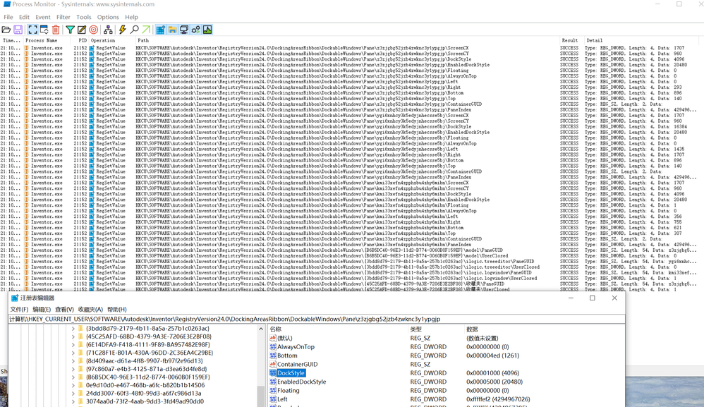

yuzeaa
@Frederick_Law  The window position of Inventor is always stored in the registry. You can read and modify the registry before displaying the window to change its position and size.Try to use the Process Monitor tool to monitor registry write actions of 'Inventor.exe' in an attempt to locate the registry options for the iLogic window
