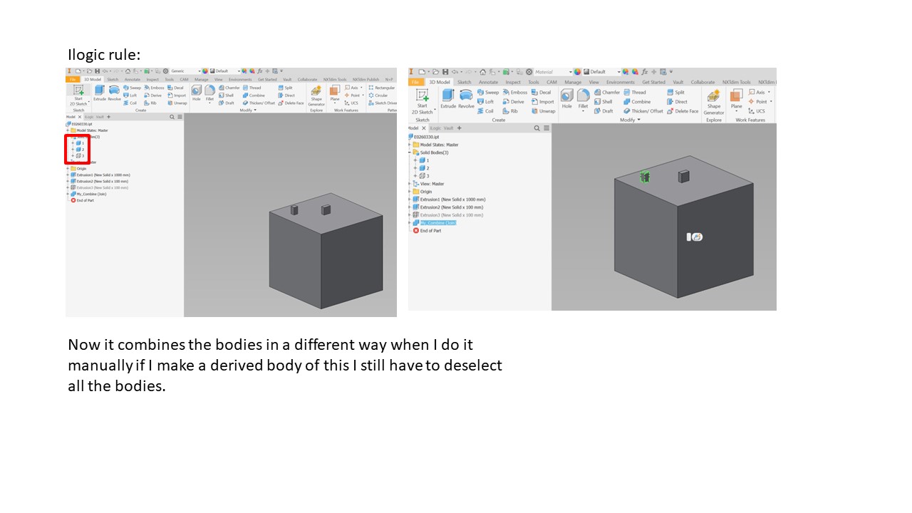

vanwees
Thank you very much for the quick response it does work in part only it does something different than I expected.
See images is this also an option in ilogic. My goal is to have an ilogic where I specify a certain volume and then it does all the small body's combine and when I make a derived body from this file that I don't take all the small body's with me.

Andrii_Humeniuk
No problem, you need to put False in line 29.
oCombine = oCombines.Add(firstBodies, oColl, PartFeatureOperationEnum.kJoinOperation, False)
