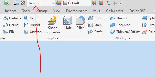

I attached your last code and now I got a local copy of my choosen material but how can I get it to be the active one in my new part? Can it be done with the script?

Hi @Gwennberg.  However your current code is laid out, once you have a reference to a local copy of the material (Asset) you want to set as your part's 'active' material, then you can set that as the value of the PartDocument.ActiveMaterial property.  That is a Read/Write property whose value is an Asset.  The part type document is the only which has that property.  Assemblies do not have a set material, because they do not contain any of their own solids...with the exception of weldment type assemblies and the weld beads you can create in them.  You can see this is what I was attempting to do in the last line of code I posted above.
