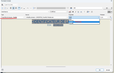

denis.semeniuc
in symbol definition place texte :
1-property of sheet
2-scale of origin view
3- place in the symbol
In the symbol you will be seed only the scale of the first object placed in the sheet.

Message 5 of 11
denis.semeniuc
or
this well be work for each parts
