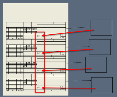

Hello colleagues,
I need to export a corner stamp ideally into Word. I need to print it on a self-adhesive label. Has anyone of you solved something similar?
Thank you
118 Views
Michael.Navara
You can easily convert TitleBlock to SketchedSymbol.
Now you can print labels directly from Inventor. This sketched symbols can display properties from different models.
VBA code sample how to copy title block "DIN" to sketched symbol "TitleBlockCopy"
