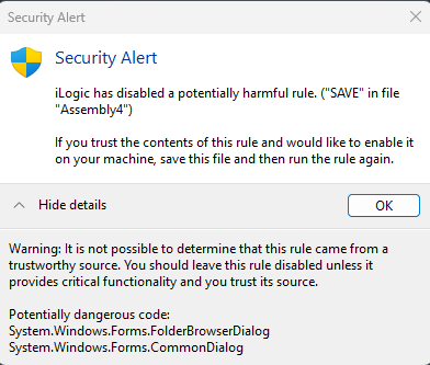

I am working on a rule that will save my file in a location I'm picking. The file name is generated by parameters.
I am getting this security alert.
I do know if I save the file the rule will work but that defeats the purpose of the rule.
Here is the rule I'm using.

If anyone has ideas for how I can get this to work that would be greatly appreciated.

Michael.Navara
This message is displayed because iLogic checks the code for potentially harmful code.
You can disable this in configuration. Or you can configure rules, folder which will not be checked.
josebaqueror
That security alert is iLogic's rule-security prompt. It fires when a rule does file operations (saving to a path, reading or writing external files) from a location Inventor doesn't trust. It isn't your code being wrong, it's the trust layer. Two ways to stop it: 1. Trust the location. In Tools, Options, iLogic (the security / Files settings), add the folder your rule writes to as a trusted path. Once the target and the rule's source are trusted, the prompt stops. 2. If it's the rule itself being flagged (an external rule running from a shared folder), add that rule folder to the trusted iLogic paths too. A rule run from an untrusted external location triggers the alert even when the save target is fine. Worth knowing: this is a deliberate safety gate, it stops a random rule from writing files without you noticing, so whitelisting the specific paths is the right fix rather than trying to suppress it in code. What does the alert actually say, and is your rule internal to the document or an external rule in a shared folder? If it's external, it's almost always the rule's own location that needs trusting, not just the save target.
