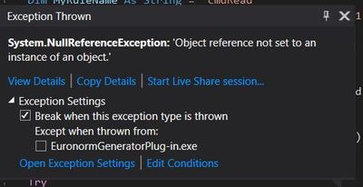

Hello again,
New post to keep things clean, I'm stuck on debugging my code. It stops at:
 Try
            iLogicAddin = _invApp.ApplicationAddIns.ItemById(iLogicAddinGuid)
            iLogicAutomation = iLogicAddin.Automation
        Catch
            MessageBox.Show("Unable to access iLogic addin")
        End Try
It shows the messagebox error
see below a screenshot and also the window that comes up with the 'Exception thrown' when i stop debugging my code. Any idea what causes this?

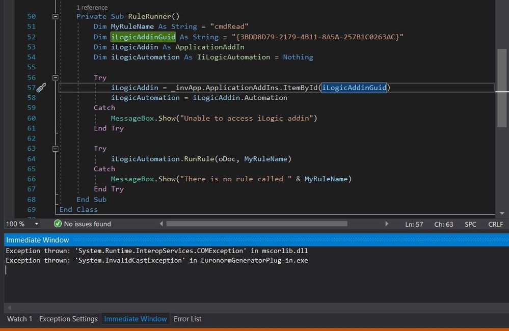

Code in insterted(in case its easier to read this way)
Private Sub RuleRunner()
        Dim MyRuleName As String = "cmdRead"
        Dim iLogicAddinGuid As String = "{3BDD8D79-2179-4B11-8A5A-257B1C0263AC}"
        Dim iLogicAddin As ApplicationAddIn
        Dim iLogicAutomation As IiLogicAutomation = Nothing
        Try
        Catch
        End Try
        Try
            iLogicAutomation.RunRule(oDoc, MyRuleName)
        Catch
            MessageBox.Show("There is no rule called " & MyRuleName)
        End Try
    End Sub
770 Views
Daan_M
i added;
Catch ex As Exception
MsgBox(ex.Message)
and it shows the following

jelte.de.jong
I did have the same problem when i started working with Automation properties of addins. The problem is that "iLogicAddin.Automation" always returns an object of the type "System.__ComObject". I never managed to cast it to something else like the type "IiLogicAutomation". but there is a solution just never cast it. That also means that you should not define the variable iLogicAutomation as the type IiLogicAutomation. try this code.
Dim iLogicAutomation As Object = Nothing ' As IiLogicAutomation = Nothing
Try
    MessageBox.Show("Unable to access iLogic addin " & ex.Message)
End Try
Try
Catch
End Try
Daan_M
@jelte.de.jong and @LukeDavenport
Thank you both so much, Jelte's tweak make the program work!
