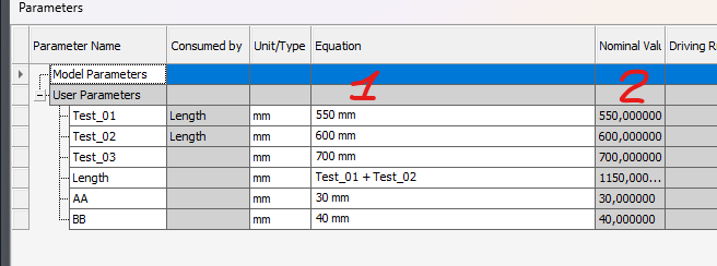

The difference in value(2) and expression(1):
In the example, the Try - Catch operator was used because an error is possible in the Try section. In the case of an error, the code execution goes to Carch.
