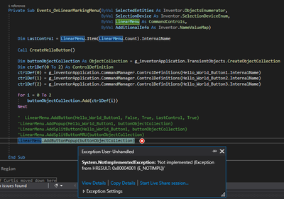

josh.nieman
Sorry, I take back everything I said 😂
API documentation makes it look trivial to accomplish, but every method I tried resulted in 'System.NotImplementedException' errors.
Pretty sure that means that while the LinearMarkingMenu (which is .. apparently a psuedo object?  An object without API support?  Only RadialMarkingMenus appear in the API documentation)  is type 'CommandControls ' it apparently does not implement all the methods/objects/functions OF the 'CommandControls' interface 😞

Curtis_Waguespack
@nmunro wrote:
Both radial and linear marking menus are available. The old school linear menus (no radial) have to be activated in the UI to enable API access.
I'm still not seeing that this works ( Inventor 2023) ... attached is my updated simple example project.
I tried adding a popup, split button, split button MRU, and a button popup... all with and the radial menu option disabled.
With this option selected, so that the radial menu is disabled... (and still using the OnLinearMarkingMenu event) , I get the not implemented error still.
I also attempted to use the OnContextMenu Event and the OnContextMenuOld events.
In those cases there was no error, but the events did nothing. ( I tried these events with and without the radial menu option enabled.)
Message 9 of 22
Curtis_Waguespack
Thanks for having a look, these were the results that I was seeing last week when trying to get this to work, as well.
Message 10 of 22
