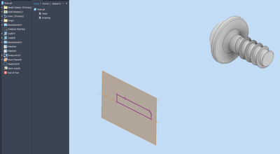

I have a closed sketch on a work plane that is a fixed distance offset from the XY plane. I also have a work axis created from one of the lines in the sketch. I am trying to perform a revolve with kNewBodyOperation to create a new solid but keep running into this error "Unspecified error (Exception from HRESULT: 0x80004005 (E_FAIL))". I tried revolving it manually and it works fine Here is my code:

This is where I am currently stuck at:
This is my desired end result:

This code segment should work by itself. I am still getting the same error on the blankRev line. The profile is a closed loop. I can revolve it manually using the tools in Inventor but I cannot seem to get it work in iLogic.
A.Acheson
So I ran the code and it brought up the error as you described. If I try to revolve manually using the work axis the revolve it will not work, the axis cannot be selected. If I use SketchLines.Item(1) as the revolve axis entity this works. So the issue is the order and dependency in which the work axis is created. If you create the work axis from the workplanes and the work axis appears before the sketch in the tree then the revolve will work. Result below is from a manual revolve. Try and replicate this workflow by code.
