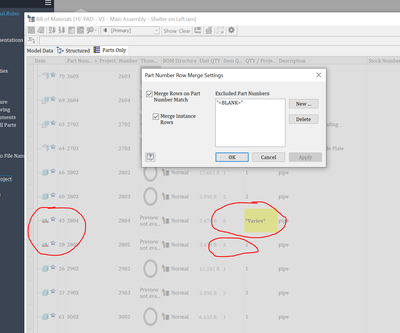

Hi! I have this code, largely from here https://forums.autodesk.com/t5/inventor-forum/structured-bom-total-quantity-of-loose-components/m-p/...  I write an iProperty QTY / Project in each Referenced Document of the Assembly with the total part quantity. This I then use in the Parts List on a drawing.
My issue is with "Part Number Row Merge" in a BOM. Does someone have a suggestion regarding this?
Can this setting be read with iLogic? In this case if the row is merged to read both quantities, add them and write this total for both, so as to be correct?
Thank you!

emanuel.c
Hi  @Andrii_Humeniuk  Thank you so much for your help!
I do actually need to write to both parts and assemblies and that's easy - I can take that clause out.
But maybe I wasn't clear. This is for the case in which the file names (and essentially the parts) are different but since they are geometrically the same they get the same part number and drawing.
As such I was thinking to read the iProperty "Part Number" instead of oRefDoc.FullFileName. Unfortunately when I try to modify this I get some error on line:
If oDict.ContainsKey(sNamePart) Then
I've never used "Dictionary" - not sure how that is supposed to work. Does that convert Integer to String?
Thank you!

Andrii_Humeniuk
Removed from the code the part that works only with parts and added a selection of not component names but their PartNumber. Hope this is what you need.

emanuel.c
Such a beautiful piece of code! It works perfectly.
Thank you very much!
