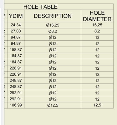

Does anybody know how to remove trailing zeros from hole table column?

nelsoncagudelo
Greetings, can you upload a capture of the table you have please
nedeljko.sovljanski
Hello @nelsoncagudelo , here is table

GosponZ
That solution round off dimension to ceiling. Unless is critical may work but i wouldn't bet.

nedeljko.sovljanski
Hi @nelsoncagudelo ,
As @GosponZ mentioned that is risky solution. If I have dimension 13.5 with precision 0 it will be 14 and with precision 0.0 I will have trailing one zero. This property exists in DimensionStyle so it could be public in HoleTableStyle also, but it is not for some reason.
theo.bot
@nedeljko.sovljanski
There are two locations to set the trailing zero depending on the column type:
If you use the description column, what is a Text column the options for leading and training zero's are not enabled.
The formating is defined in a dimension style, that is define in the object default style under "Hole Tag".
For other columns of the Type Number you can set the training or leading zero's in the format column options
