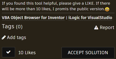

Maxim-CADman77
Wow, 10 Likes per day!
Update:
..already "more than 10 Likes"
