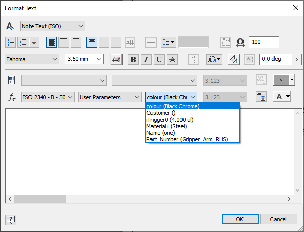

I would take a slightly different approach.
I would always pull data to the drawing, from the drawing itself, in the image below, you can see that it's really easy to get to the user parameters of a part.
BUT, depending on the application, you probably don't need any iLogic, if you are just looking to pull data from the part/assembly.
If you add text to your drawing, you can include any of the model or user parameters on the drawing.
