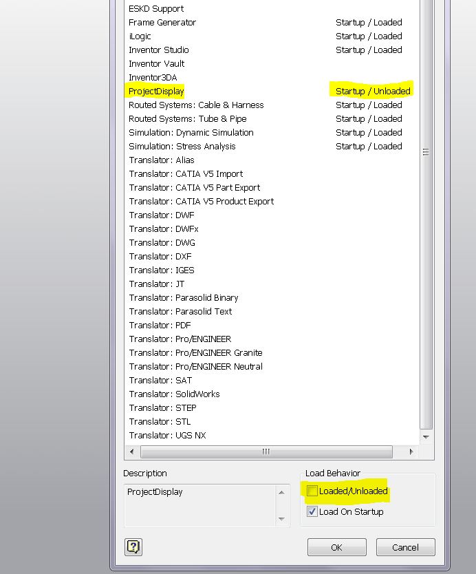

just unzip the folder from the message before into the "Addins" folder on your c drive.
Inventor is looking for a file with and "dll" or "addin" extension in that folder.
Inv will start this addin on every start.
Also, make sure that you're add-in manager has the addon in it and loads it on start up. (see attached pic)

Dan_Margulius
Thanks for helping,but still its not working.i built a folder and put the files there and installed even but there is no addin in inventor like in your picture.

Dan_Margulius
Hello Mike,
In 2011 it works but not in 2010. the addin appears but is always unloaded. Even if I load it and get back to addins later
again the checkbox load/unload is unchecked.
