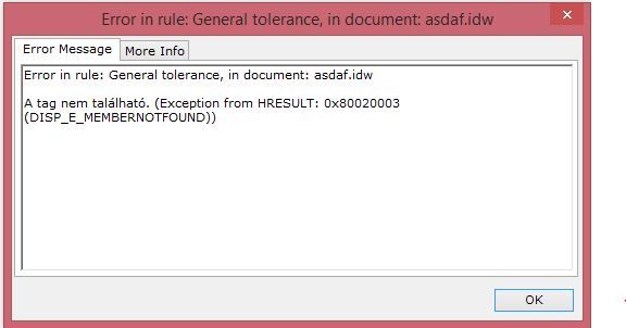

Hello All,
I use this rule to delete Sketched symbol if model of drawing is assy.
It is work 29 times in 30, but sometimes appear an error massage.
I have debuged the rule (with msg box), and it stop after ComponenetDefinition.Type.
I try to add this parameter to msg box. Usually I get a code (at part it is: 83886592, it works fine), but sometimes error message.
When I find a part what have this problem and create a new base view about it, the rule works fine.
So I cannot find any context between error messege and component of drawing.
How can I fixed this problem?
Any other way to make different assy and part?

Try this:
Dim oDrawDoc As DrawingDocument = ThisDoc.Document
Dim oSheet As Sheet = oDrawDoc.ActiveSheet
Dim oViews As DrawingViews = oSheet.DrawingViews
If oViews.Count = 0 Then Exit Sub Dim oDoc As ReferencedFileDescriptor = oViews(1).ReferencedFile If oDoc.DocumentType <> DocumentTypeEnum.kAssemblyDocumentObject Then Exit Sub For Each oSymbol As SketchedSymbol In oSheet.SketchedSymbols If oSymbol.Definition.Name = "General tolerance" Then oSymbol.Delete() End If Next

What can I do if I want to indentify a Sheet metal model.
The rule is the same, but at Sheet metal I want to do something.
That is why I use ex.
ThisDoc.ModelDocument.ComponentDefinition.Type <> 150995200
Owner2229
Here you go:
If oDoc.DocumentSubType.DocumentSubTypeID <> "{9C464203-9BAE-11D3-8BAD-0060B0CE6BB4}" Then 'Do somehting
