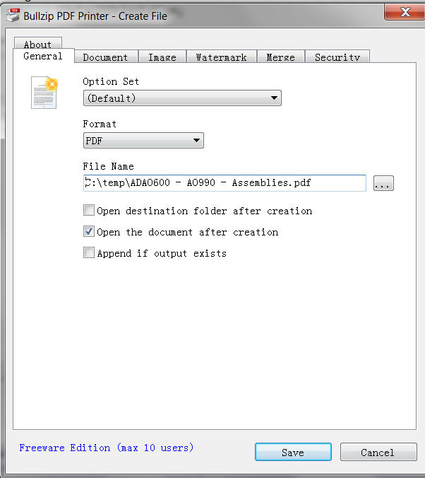

Hi Martin,
I installed "Bullzip PDF Printer" and tried to print. It always pops out a dialog. I have no idea how to mute it when running batch with your code.
is there any trick?
Thank you.

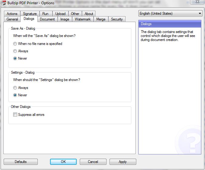

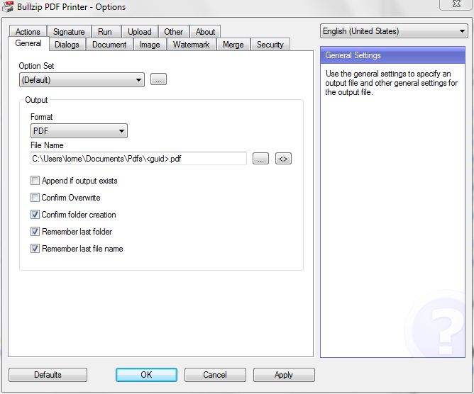

Message 10 of 13
  If you open the options dialog (just type BullZip PDF Printer Options in the start menu of Win7) you can set this. I have mine set as follows. The <guid> option chooses a unique name for every file. It does insert a watermark for the free version but this will not matter for our application.
Message 11 of 13

Hi Martin,
Sorry for my late response! I was on a holiday.
I disabled the dialogs of Bullzip PDF. I chose the mode: Append if output file exists. Most iterations printed out the pages smoothly, while occasionally, an error message will pop out to pause the process (as the figures below). I had to click OK manually. And the code will fail for one iteration, the index is not specific. I tested three times. The first time I got 140 pages, the second time 89 pages, the third 110 pages. Although all pages look well, I have not got more than 200 iterations so far.
It looks there are some tricks to reproduce the scenario?

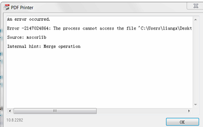

Message 12 of 13
   I can't quite make out the text in your screenshot but i am wondering if there is a problem writing to the pdf file if the previous operation isn't quite done. That is one of the reasons why I chose to create a separate pdf for each drawing.(See my screenshots in the previous post). Also I never did mention, we are still on Inventor 2014 here, I don't know if the Autodesk.Inventor.Interop.dll has changed since that or not.
Message 13 of 13
xiaodong_liang
Autodesk Support
Autodesk Support
Hi Martin,
sorry for the unclear image. The first image tells the error occurs in the stage of merging file. While the second image is just an error which does not tell any useful information.
I followed the setting and printed the PDF files with GUID name. About 2000 PDF are generated. All looks well. The problem did not reproduce at my side. I am using Inventor 2014 + SP1, but I do not think the problem is relevant with Inventor version, but some settings on specific machines.
The below is my test video:
