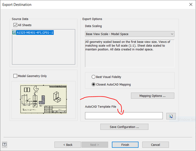

Hi everyone!
I need to have the code in Ilogic or another way to print all drawings I want to PDF file quicker.
Besides, I also need the code to export all drawings I want to DWG.
If you have any solutions, let's feedback in this post.
Thanks for your attention!

You'll need ini file with DWG export setting.

Frederick_Law
Here is addin for the same thing.
Extract the folder to: %AppData%\Autodesk\ApplicationPlugins
It'll add 3 icons to ribbon.
Open a idw, the addin will export all idw in the same folder.
buitrongcuongypbn2000
Thanks for your support!
But I can not active this tool.
Could you post the video guidance for me?
Thank you very much!
Frederick_Law
Which one you cannot activate?
What have you done already?
If the addin is in correct folder, enable it here:
I have succeeded with your tool. But I still have a new problem.
I need to add a template file AutoCAD here.
Do you have anyway?
Best regard,
Frederick_Law
Sorry I don't.  I just export idw with Border and Titleblock.
You can edit the VBA marco to include Template.
