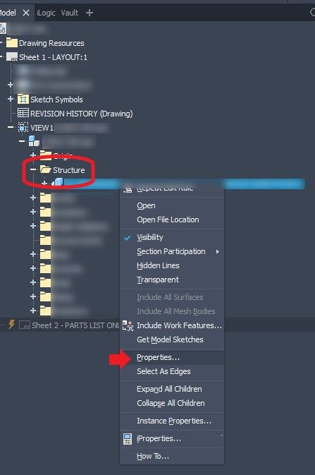

Is it possible to assign a specific layer / line type to all drawing views of a component that resides in a specific folder?
Every top-level assembly design we do we have to manually assign the "Dotted" line type to one of our components in a named folder in the browser called "Structure". We do this by right clicking on the model in the Structure folder, click Properties..., in the Component Properties dialog box we uncheck "By Layer" and then  manually assign the "Dotted" line type via the dropdown. I would love to be able to automate this with iLogic so that our colleagues don't have to remember this manual step because some are forgetting this step.

Hi @kwilson2D66D9.  Yes...sort of, but it is not nearly as simple to make happen by code as it is to do manually.  There would be many steps involved, and a couple different forks in the road, as to which way we could do it, depending on the details of your preferences.  And what we do by code will generally only affect or be applied to individual views in the drawing, but the code can do the same process for each/all views in the drawing, if necessary.   But lets get a couple questions out of the way first.
  • How to find/get the component occurrence
    • Will that folder always exist, and its name always spelled the same, and its letter capitalization always the same?
    • Is there always just one occurrence in that folder?
      • If more than one may be in the folder, then how to find the one you want in that folder?
  • Does Line Weight or Color matter?
  • Will the view always be referencing the parent assembly, and not just that one component directly?
Navigating the 'model browser tree' by code in a drawing is more complicated than doing so in a model file.  The same component can sometimes be found in multiple places, and under multiple drawing view nodes, therefore it is sometimes easier to find something like that in the referenced model file instead of the drawing's own browser tree (by code).
One of the two main 'branches' in the code path is to apply changes to each individual drawing view curve it finds belonging to that one occurrence, which takes much longer to process.  The other main branch collects all of the drawing view curves that we need to change, and sets them all to another 'Layer' at one time, which processes much faster.  But the 'alternate' Layer needed may not exist in that drawing yet, so it would usually need to be created first (can be done by code), before we can set drawing view curves to that Layer.  And of course a Layer has several different specifications.  Either way, these types of changes can be difficult to change again later, if you change your mind about something, or if the model updates, which may change things in the drawing view.  There have been several topics on this forum about similar tasks, and many of them already have 'accepted solutions'.  They may give you some ideas about what is involved.  But we can also help out here too.

Below is a rough draft of the code you can use in an iLogic rule which you can start out with for this type of task.  There are a lot of opportunities for something to not work as planned, which is why you will see a lot of 'Try...Catch...End Try' statements in there, which 'handle' (block) the usual errors that would normally pop-up when something causes an error.  In each of those situations, we can insert some code on the 'Catch' side (like a Logger entry or MsgBox) that will be ran instead, when it catches an error, if you would like more 'feedback' about when those errors happen.  When you run this rule, it expects a drawing to be the 'active' (visible on screen for editing) document.  If that is not the case, it will simply not do anything.  This example will attempt to create a Layer named 'StructureLayer', if it can not find an existing one with that name.  If it has to create the Layer, it simply copies the first existing Layer in the drawing that already exists, then changes its Line Style to the 'Dotted' variation, so color & Line Weight may be different.  All this stuff can be changed later, once we figure out if it will work.  I included the use of a 'Transaction' in this rule, to record all of its actions into one item in the UNDO list, so they can easily be undone, immediately after it finishes, if necessary.
