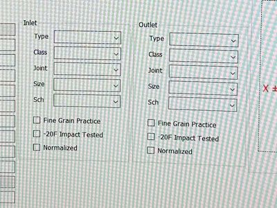

Good afternoon everyone,
is there any one out there that knows how to populate a combobox by pointing to a family’s key column and then the next combobox narrows it down and so on. Essentially the same way content center works with listboxes but with comboboxes. I’m working on a form and would love to be able to drive and pick all my components from one form.
-Jeremy

Could you explain the type of form your using? You might have a better time creating a winform explained here and then populating with the family table data. Do you have the code required for accessing the family data? If so attach here, if not there is some samples on this forum.   Could you attach an approximate sample of what you want to achieve, where your selecting the family information and hopefully someone can point you in the right direction.

I already have a form created. I’m using Visual Studio. I’m not quite sure how to reference the family keys into each combobox.
Type: is the family (Heavy Barrel, Long Weld Neck)
Class: (150,300,etc)
Joint: (RF,RTJ)
….and so on, by the time you have selected the options you have narrowed down to correct part to place or replace.

thank you for this code it will come in handy, but im looking for a method that targets the key column for each combobox and returns a list of options in the combobox. i dont want to hard code the key options because then i need to constantly update my addin. if its referencing the key columns any changes in the CC family will automatically update in the addin.
