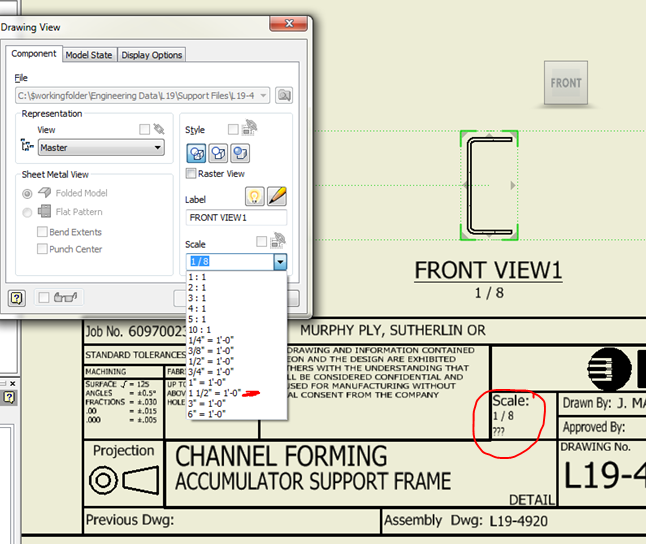

kinda a side question but would you happen to know what I need to do if I want my scale in the drawing view to be 3" = 1'-0"
Format:HTML Format Version:1.0 StartHTML: 165 EndHTML: 600 StartFragment: 314 EndFragment: 568 StartSelection: 314 EndSelection: 314SyntaxEditor Code Snippet
DrawingViewScale = ?
JaneFan
Hi Joel,
I don't quite understand the question about the scale value 3" = 1'-0". DrawingViewScale only accepts double input. You can set it to any double value as needed.
Drawing view scale can be set either when calling DrawingViews.Addxxx() functions, or after drawing view being created, Modifying the property of drawing view: DrawingView.Scale.
Jane Fan
Inventor/Fusion QA Engineer
Hi Jane,
This is what I mean..i set the drawingscaleview to .125 which is 1/8 scale but I want it to say 1 1/2" = 1'-0" just the drop down shown below.  What should I change in my code then? Thanks for your help!
