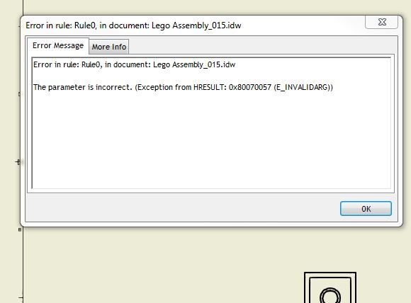

Thanks for the replies.  So it sounds like it's not a version issue. And I've tried this with our template, and with a generic template, and I get the same results, so I don't think it's related to the file, but I've attached a drawing here just in case.
This is what I'm seeing. I get an error, when trying to place the parts list via code, but if I place one manually first, then the code works:
It appears that the assembly BOM must be set to use the "First Level" Structured Properties? In this video when I set the BOM to use First Level the code works, but when set to use All Levels it does not.
Can anyone validate that this is the case?
Thanks again,
Curtis

@MisterZS wrote:
I just tried and works on my Inventor2017. No problem at all...
Hi MisterZS,
Thanks for looking at this. Are you saying that you were able to get the code to work with an assembly that has the "Structured Properties" set to "All Levels" , with no problem at all?
Also thanks for the code example. I don't see anything in that example that is different concerning the parts list level, but I ran it anyway and I get the same error when I try it with an assembly set to "All Levels" .
Can you confirm that you can place a parts list for an assembly set to use All Levels using your example?
Thanks again,
Curtis

Capture.JPGNo for all levels it doesn't work

As chandra.shekar.g mentioned the API help says that the specifying the PartsListLevel is optional, but it seems maybe that is not the case?
I suppose I can just use something like this:
'create parts list
Try
	oPartsList = _
	oSheet.PartsLists.Add(oDrawingView, oPlacementPoint, _
	PartsListLevelEnum.kStructuredAllLevels)
Catch
	oPartsList = _
	PartsListLevelEnum.kFirstLevelComponents)
End Try
Curtis

Hi @Curtis_Waguespack,
When property of "Structured" is set to "All Levels", Exception thrown and says that "The parameter is incorrect".
