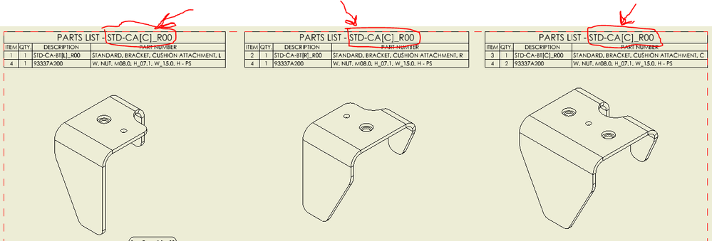

Expanding on the posted code from earlier, I would like to add a part number to part list titles as well.
In my particular case, I need to create IDWs that are as condensed as possible. To accomplish this, I sometimes need to show multiple configurations of iassemblies/iparts on one sheet. I agree it's less than ideal, but I don't make the rules 😄
So, I have re-worked the above code to iterate through each sheet and add a part number to each part list. I have two problems though:
-> using a for loop to step through each parts list in a sheet doesn't seem to work due to sheets not being containers(?).
-> I have verified that i'm accessing different parts lists, but I'm getting the same part number on all titles of all iparts and iassemblies. I think this is because iassemblies don't have individual iprops? or maybe this has something to do with the way part lists reference parts?
Help appreciated.

Message 18 of 33
Ruffy85
Hi @Anonymous
i cant realy follow you. What you trying to do?
You have multiple Sheets and on each Sheet you use Configurations of Ipart? And your Title should be follow your Ipart Iprops?
