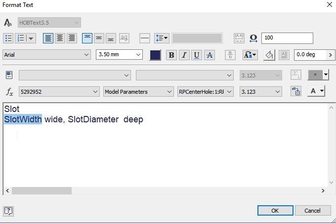

Hello All ,
                I hope you all are good . I am getting an issue i.e. parameter is not getting linked in leader note. I got vba code and I have converted it and used in c#. But parameter is not linking there. Please check the bellow code and let me know where I did wrong.
try{
ObjectCollection leaderPoints = invApp.TransientObjects.CreateObjectCollection();
Point2d notePoint1 = cm1.Position.Y < cm2.Position.Y ? cm1.Position : cm2.Position;
Point2d notePoint2 = cm1.Position;
notePoint2.X += notePoint1.X < baseView.Center.X ? -baseView.Width * 0.25 : baseView.Width * 0.25;
notePoint2.Y += drawingConstant.FontPlacementConstant * 5;
leaderPoints.Add(notePoint2);
leaderPoints.Add(notePoint1);
string Dia = FeatureParameterConstants.SlotDiameter ;
string holeDia = "<Parameter Resolved='True' ComponentIdentifier='" + drawingDoc.FullFileName + "' Name='" + Dia + "' Precision='0' ></Parameter>";
string Depth = FeatureParameterConstants.SlotDepth ;
string holeDepth = "<Parameter Resolved='True' ComponentIdentifier='" + drawingDoc.FullFileName + "' Name='" + redirectionDepth + "' Precision='0' ></Parameter>";
var holeNote = $"Slot{System.Environment.NewLine}{Dia} wide, {Depth} deep";
LeaderNote leaderNote = drawingDoc.ActiveSheet.DrawingNotes.LeaderNotes.Add(leaderPoints, "Temp");
leaderNote.FormattedText = holeNote;
catch (Exception Ex)
throw Ex;
Thanks in Advance ...!!

Hi @Anonymous
I don't think you can use parameters from the actual drawing document in a formatted text. Maybe I'm wrong but I cannot find a way to do it manually which is a strong indication that I'm right 🙂
Because I assume your variable "drawingDoc" Is the actual drawing document?
You can however use parameters from any document that's referenced by the drawing. For example this iLogic rule will set the formatted text of a drawing note the user selects to the parameter Test from the document referenced by the drawings first view 🙂
Dim oNote As GeneralNote = ThisApplication.CommandManager.Pick(SelectionFilterEnum.kDrawingNoteFilter, "Pick drawing note.")
Dim oDoc As Document = ThisDoc.Document.ActiveSheet.DrawingViews(1).ReferencedDocumentDescriptor.ReferencedDocument
oNote.FormattedText = "<Parameter ComponentIdentifier="+ "'"+ oDoc.FullDocumentName +"'" +" Name='Test' Precision='1'></Parameter>"
