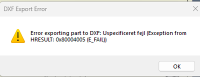

Hi @WCrihfield ,
Thank you for your quick response.
I get this error 6 times:
But when i have pushed the ok button 6 times, it does create the PDF and DXF "02. DXF", but the "06. DXF - Cut" folder and the flat pattern files within the folder is not created.
And when i try to create them again and overwrite the files it promps me, if i want to overwrite the files:
madstrolle
And btw it is set to "silent operation"
madstrolle
Hi @WCrihfield
FYI.
I got the rule working😊
I delete the files inside "02. DXF" folder at first and then create new ones.
Here is the code:

    Dim sDXF_DrawingFile As String = System.IO.Path.Combine(sDXF_folder, sFileName & ".dxf")
    Try
        ThisApplication.SilentOperation = True
        oDDoc.SaveAs(sDXF_DrawingFile, True)
    Catch ex As Exception
        MsgBox("Error exporting drawing to DXF: " & ex.Message, vbExclamation, "DXF Export Error")
    Finally
        ThisApplication.SilentOperation = False
    End Try
End If
