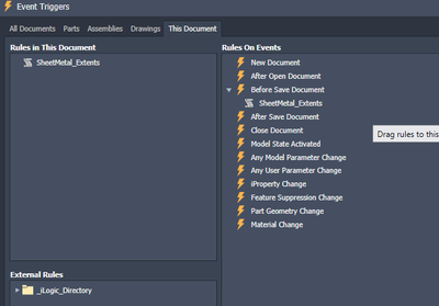

@AndrewHumiston please check the picture below, thank you.
@daltonNYAW9 This is the result of the code you created :
Spoiler
Screenshot 2024-07-19 233939.pngScreenshot 2024-07-19 234004.pngScreenshot 2024-07-19 234046.pngScreenshot 2024-07-19 234104.png
This is the expected result (for Rules or External Rules) :
It's very tiring, if you create 1 rule for each structural part with hundreds of parts, so I expect that with 1 rule at the top level assembly I can create a custom iProperties & Project Description.

@daltonNYAW9 Thank you, I'm very happy for your respons.
This is the result with the code you created.
The ‘<Family>’ does not appear in the description (structural shapes)
Thickness, Length & Height (=G_H = Width in BoM) does not appear in the custom
Perfect, but can the thickness be made x,x leading zero, ie :
0,5 --> 0,5
1,0 --> 1
1,5 --> 1,5
I need this all : Thickness, Length & Width
This is the reason why I need Custom iProperties earlier.

my Event triggers:
Exported Values:
i hope this helps!

AndrewHumiston
Easy Fix!
use your event trigger and store the rule externally.
then any part you open will be wrapped up with the extents information
Message 16 of 18

@AndrewHumiston
I havn't messed with global rules much, but u still need to add the "trigger" for every part, right?
Message 18 of 18
AndrewHumiston
Afternoon,
you can add per file, or per file type, see attached screen shot. I hope this helps.
