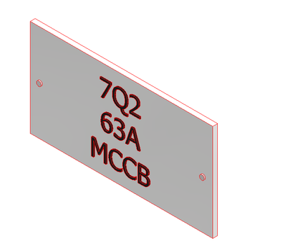

I want to create number plate based on the excel file.
Through iLogic program is created.

 After run the program,
The following error message is occurred.
Error on line 40 in rule: Rule0, in document: PANEL NAME PLATE.iam
The parameter is incorrect. (Exception from HRESULT: 0x80070057 (E_INVALIDARG))
How will I modify the iLOGIC program., Kindly advice on this.,

batuhanozmen98
Ok I think I find the solution. You need to override the style of formatted text when pushing. Fontsize is in cm so if you want 7mm you need to input 0,7
oText.FormattedText = "<StyleOverride FontSize='0,7' Bold='False'>" + slastPN + "</StyleOverride>"

mahesh_s493TE
Hi, Thanks a lot, finally I got the solution given by you.,
The text size changed to 7 mm.
