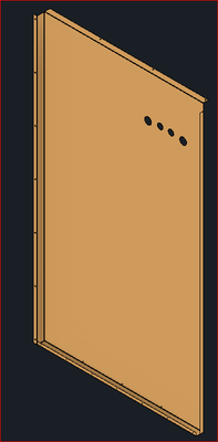

Hi @JelteDeJong  thanks for your quick response , sorry for the confusion , is it possible to get how many sides has bend for example the below part has 4 edges so all edges will have 4 bends .
