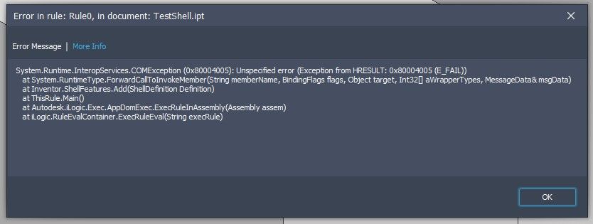

kresh.bell
ok, it works but only one face can be selected and I can't run the rule on the body it created after the first time, shows an error
JhoelForshav
@kresh.bell
Ok, so this was really driving me crazy. The thing is that when you create a shell with ilogic/API it'll always try to create it in on the first solid in the part. That's why it doesn't work the second time (The thickness of the first solid is too small). Only after you've created the shell can you change the affected bodies of the feature... One would think that you should be able to set the affected bodies when you create the ShellDefinition but there's no property in that object for affected bodies....
So I made a workaround. I first set the thickness to something really small. That way we make sure it's possible to create a shell in the first body. Then I create the shell and set the affected bodies. After that I change the thickness to the input value.
Also, I added a loop so you can select multiple faces.
