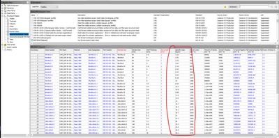

I'm using Inventor professional 2023, I have a ilogic which does the following function.
It helps me to select a part from an assembly (Its basically a assembly made from content center structural parts), so when i slect a part using the Iloic code 1 it assign weight data and pulls size data from content center and also it create a custom user paramater and assign the list of values available in the size column and mass columns to its respective parameter. then with ilogic code 2 when I select a specific size from dropdown in the form. it will calculate the new weight for the new size. see below images
Form
Created user paramters with dropdown

but I have a problem here , the mass data is reordered in ascending from 1 to  9 but I want to assign the data in the same way as it is in content center so that the mass will be assigned correctly for its respective size.
Image 1 :order in content center
Image 2:order in my dropdown paramter
It reshuffle   in increase from 1 to 9 , i want the same order as in content center, kindly help me
Also In the form, I want to add the total weight of assembly also come in the form and also it show show new total weight because of the change of new size . Refer image below
@Andrii_Humeniuk , hope you can help me on this

Hi @khantheking1995 . Sorry. I haven't answered you before, I've been very busy. I hope the following changes to the rules will fix your problems:

	If Not oExpList.CustomOrder Then oExpList.CustomOrder = True

Require a small update in the above code as follows.
Once it identifies the mass column, I want the code to get the name/description o the mass column and assign it to a variable, for example, X is the variable then (as [per image)
X = mASS (Kg/m) [Kg/mm]
Then from the variable it should extract the unit of mass whatever mentioned between [], here it is mentioned Kg/mm between [] then it should convert the value to equivalent kg/m.
The unit can be anything that represent Mass/Length (kg/cm, kg/mm, kg/m, lb/ft, lbf/ft, lb/in,lbf/in) to kg/m
Also, I have save the recent code but it didnt showed up the total existing assembly weight and new assembly weight in my form like below image, is there any setting I have to change in my form?

HI @Andrii_Humeniuk
most of the issues resolved now except for the rounding of inaccuracy
I see that the code for rounding off works fine but i see the inaccuracy comes from the Length.
The program pulls the length as follows(see below example)
In the below image I selected the marked part and I got the length as 33.02 and this comes from the sketch (see image 2)
In the image the length is 1300 in thats comes to 33.02 m when converted, this cause inaccuracy.
To avoid this , we need to pull length as shown in below image
The Frame member data show accurate length that the shape utilize but in different units(mm, m, in, ft etc) so the length data should be pulled from here and should be converted to meter and should be used in our code.
Hope you can do this, also i need a code to automatically generate the form(below image) in global forms as shown below when the Partselect code is pasted and clicked save and run.
