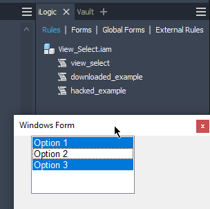

Hey all,
I'm trying to code up my first Multiselect ListBox, but am getting a little lost in the methods available for execution. Here's where I've started - the below simply pushes ViewReps into an array and displays them as an InputListBox

Unfortunately however it doesn't allow for user multi-selection (unless I'm mistaken?) - The user will be needing to process some ViewReps, but not all, so I figured that through a multiselect ListBox would be the easiest way for the user to progress with ViewRep selection, and their selections then execute via my main sub (not detailed here).
Researching the topic of Multiselect ListBox lead me to reading the below two articles;
https://knowledge.autodesk.com/support/inventor/learn-explore/caas/simplecontent/content/create-wind...
https://docs.microsoft.com/en-us/dotnet/api/system.windows.forms.listbox?view=windowsdesktop-6.0
So from these two articles, I can mash together a semi-functioning Multi-Select ListBox with string values, as per below;
However I've been unable to figure out how to inject my own viewRepList array list into my hacked up Autodesk / Microsoft article code example below;

I'm so very close to getting this working, but it's just a little bit deep-end of the pool for me, so to speak. Would appreciate any guidance, that's for sure! Or perhaps there's an easier way - such as, I have considered individual check-boxes as an alternative solution, but figured will try this MultiSelect ListBox method first.
Thanks!

Yah, as I tried to reverse engineer the code, I was commenting out lines that I was yet to fully understand. I could see that the AddHandler was required, but it was conflicting with other inserted code as I tried to figure things out - and commenting out allowed me to at least capture the screenshot of what I was trying to achieve.
Massive shout-out to @JelteDeJong - that executes well! I will have a look through what you've crafted here to gain a better understanding. Would you happen to have any tutorials or learning resources to recommend?
