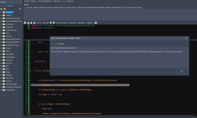

Hi @NachoShaw
Since upgrading to Inventor 2025.2 I get an error when running this code, here:
Can you help me with this?
Thank you very much!

In the Addreference section at the top of the ilgoic rule, add this line to it
AddReference "System.Private.Uri"

Thanks for the input @g.georgiades
It fixed that issue but here is a next thing popping up...
