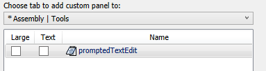

I have been going mad about this situation. I have followed multiple steps on how to change macro icon and nothing has worked. Can some one look at the attached pictures and tell me what I am doing wrong please???
Also I have tried to restart inventor and windows multiple times to see changes but this has not worked.

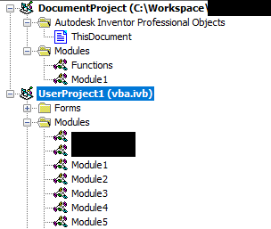

Not much to go on with those pictures honestly, so I will just try to hit all bases.
Please share a picture of the vba editor sidebar like I have below.
Please ensure your module/code are in a user project, not a document project.

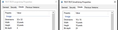

PG_Tips
picture of the vba editor sidebar as requested.
the sizes are as you have said.
i have restarted inventor and also the computer several times with no luck.

g.georgiades
Here are some pictures that definitely work for me, small and large.
Message 7 of 11
PG_Tips
this works!!!!!!!!

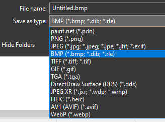

g.georgiades
If your images are bad, that makes me think you did not save as bitmap properly?
Take any image pre-resized to 16x16 or 32x32, and export it to bitmap format. You have to ensure it converts the image format, not just changes the file extension. I personally use paint.net, but i believe windows paint will convert, or gimp, photoshop, online tools, etc.

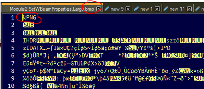

0x3FA5
YES!!
This is what was not working for me.
You can check the correct file format by opening the picture file in any text editor, here I just changed the extension:
